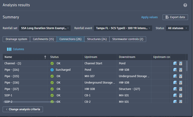

- Added an option to include Rainfall, Runoff and Storage Curve graphs to the Excel reports exported after running a drainage system analysis

- Improved the apply-results function to return the maximum flow rate in a pipe to the Flow Rate property, and the corresponding return period (when IDF rainfall is used) to the Return Period property

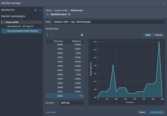

- Improved the Rainfall Manager dialog box with fixes to borders, columns and tooltips

When a drainage engineer prepares to analyse a system, the analysis can be initiated directly within Civil 3D. This allows for the utilisation of various rainfall and runoff methods and facilitates the execution of multiple storm event simulations. Upon completion of the analysis, engineers can validate results, including any warnings or errors, before applying them to the drainage components within the drawing and exporting a comprehensive analysis report.
To support the analytical workflows, a rainfall manager for the creation and management of rainfall events is included. Learn more.
