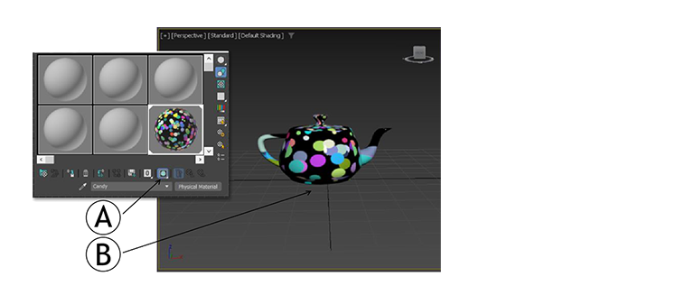

The main Material Editor control for shading materials in viewports, and toggling display of maps, is a flyout with four possible states:
Note: If you are using a legacy viewport driver instead of Nitrous, these options read "Standard" and "Hardware" rather than "Shaded" and "Realistic," as they did in versions of 3ds Max prior to 3ds Max 2012.
Tip: Choosing the alternate flyout button does not toggle the button state. For example, if Show Shaded Material In Viewport is off for the active material, choosing Show Realistic Material In Viewport simply switches the material to Realistic display mode; it does not turn on the maps. You must turn on the button explicitly to see maps in viewports.
The Slate Material Editor indicates that map display is on with a diagonal red shape in node title bars, the Material/Map Browser, and the Navigator.
This control is also available at the map level, where it functions only as a toggle for the option set at the material level, and applies only to the active map. So, for example, you could enable viewport display of the bump map while disabling display of the diffuse map, although both would appear in the final rendered image. Changing the setting at the material level overrides any map-level settings.
Note: If the toggle is unavailable at a map level, it means viewport display of the map is unsupported. One possible reason is that the map is nested too deep in the material tree.
