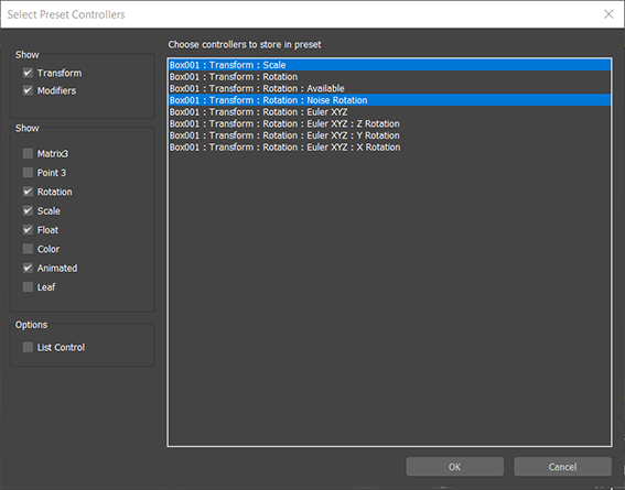

  1. With one or more object selected, select Animation > Presets > Create Preset to open the Select Preset Controllers dialog. For this example, a box with a noise controller is used.
    Box with a noise controller
  2. In the Select Preset Controllers dialog, choose the controllers you want to use in your Preset and click OK.

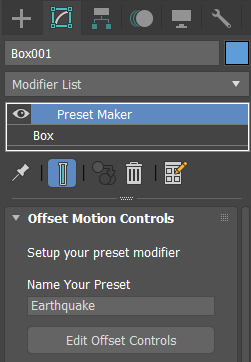

    A new Preset Maker modifier appears in the modifier panel.
    Note: You can only have one preset per node.
  3. Name the Preset and click the Save Preset button. In the example, the Preset was named "Earthquake".
    Preset Maker
    The Animation Preset is in your Project folder, under scene assets > animations > presets.

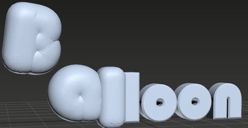

Presets allow you to create offset animations; for example, a balloon animation. If you wanted all your text to blow up like a balloon, you could use a smooth modifier, a relax modifier and a push modifier, and all those three modifiers would have the text blow up like a balloon.
You can build up a more complex set of instructions, save them, apply them as a preset, then apply the preset to other objects. You could then select each object and manipulate the controllers, such as time controllers and preset modifiers. For example, you can change the object's timing to be 5 frames instead of 10 frames, or, rather than the animation playing forward, to play backward
