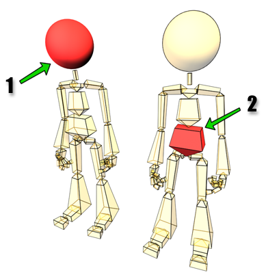

Choose an object near the structure’s center of mass, or center of gravity, as the root of the hierarchy. The center of mass in the real world is the point on an object about which reactions to external forces are applied.
1 and 2 each represent the root of the characters.
Both structures are suitable for forward kinematics.
The structure on the right is best for most inverse kinematics.
The figure above shows two approaches to linking a skeletal structure. Either structure is suitable for working with forward kinematics. The structure on the right, however, is a better choice for working with inverse kinematics.
The structure on the left has the arms and torso linked to the neck. The structure on the right links the arms and neck to the torso, a more realistic approach.

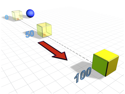

Imagine linking a stationary sphere to an animated box.
At frame 0 the box is beside the sphere.
At frame 50 the box is 20 units away.
Original animation, with ball unlinked and stationary while the box moves.

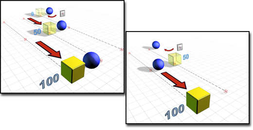

Linking the sphere to the box causes the sphere to move with the box. The distance between the sphere and the box depends on the frame when the link is made. Linking the sphere on different frames has the following effects:
Link on frame 0, and the sphere stays next to the box as it moves.
Link on frame 50, and the sphere stays a distance 20 units away from the box as it moves.
Left: Ball linked at frame 0 follows the box on the side.
Right: Ball linked at frame 50 follows the box 20 units away.

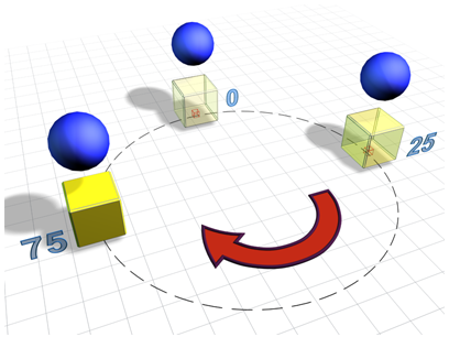

Imagine a sphere linked to a box moving around the face of a clock. The box starts at 12 o'clock and travels all the way around the face over 100 frames. The figure shows a box moving in a circle with a sphere linked above it.
Original animation, with ball linked to follow the animated box.

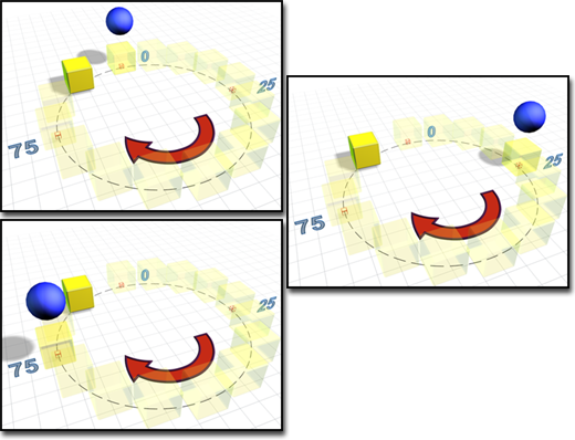

If you unlink the sphere, it stops following the box. The position of the sphere depends on its position, rotation or scale at the frame on which the link is removed. Unlinking the sphere on different frames has the following effects:
Unlink on frame 0, and the sphere stays at 12 o'clock.
Unlink on frame 25, and the sphere stops at 3 o'clock.
Unlink on frame 75, and the sphere stops at 9 o'clock.
Clockwise from top, position of the sphere unlinked at frame 0, 25 and 75, respectively.
