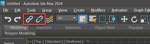

Use the Select and Link button to define the hierarchical relationship between two objects by linking them as child and parent.
Select and Link and Unlink buttons on the toolbar.
You link from the currently selected object (child) to any other object (parent).
