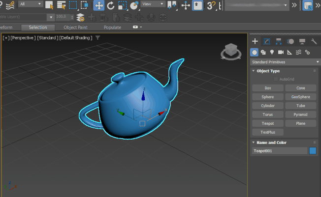

To reposition an object's pivot point:
  1. image Select an object and then turn on image Hierarchy panel > Adjust Pivot rollout > Affect Pivot Only.
  2. image Move or image rotate the pivot.
    You can also use Align, Quick Align, and Align to View on the toolbar to align the pivot.
