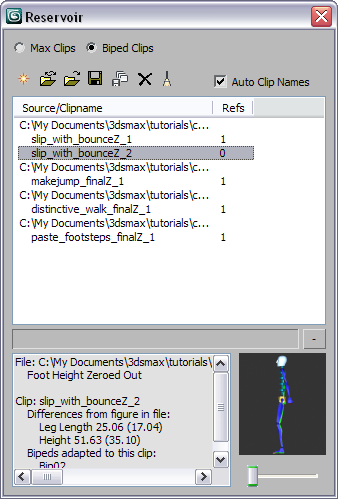

The Reservoir serves as a storage facility for motion clips ( BIP files and XAF files) that you use with the Motion Mixer. You can load clips directly into the Reservoir, and all clips that you load directly in the Motion Mixer also show up in the Reservoir.
For each motion file used in the Motion Mixer, the Reservoir list shows the source (disk path and name of the file), and, under the source, shows the name of each clip or set of clips derived from that file.
The Motion Mixer can apply multiple adaptations (occurrences of the clip for different-sized bipeds) to different bipeds. In the Reservoir, the various clip adaptations are listed under the clip name.
If you click a clip in the list, the window under the list displays information about the clip, including structural differences between the figure it's applied to and the figure from which the file was originally saved. A second window displays a graphical view of the biped animation; drag the slider below the window to move through the animation.
Note: The preview window is available only for BIP files.

  1. Choose between Max Clips and Biped Clips.
  2. On the Reservoir toolbar, click image (New Entry).
    The Open dialog appears.
  3. Find the directory containing the clip files to load, highlight the desired file or files, and then click the Open button.
    The file loads and appears as a Source in the Reservoir list. You can then add it to a track in the Motion Mixer using the latter's New Clips > From Reservoir command.

To remove clips not used in the Motion Mixer from the Reservoir:
If you delete all instances of a clip from the Motion Mixer, it appears in the Reservoir with a Refs value of 0.
