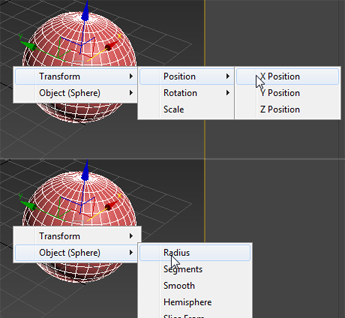

  2. Right-click the box, and from the quad menu choose Transform quadrant > Wire Parameters.
  3. From the pop-up menu, choose Object (Box) > Length.
    A rubber-band dashed line now connects the box and the mouse cursor.
  4. Click the sphere and choose Transform > Position > Z Position from the pop-up menu.
    The position of the sphere and the length of the box are now wired.

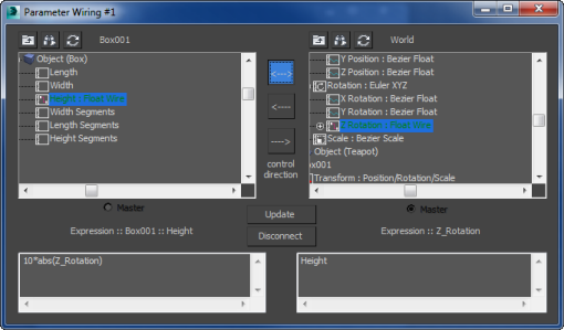

  5. In the Parameter Wiring dialog, create a one-way wire by clicking the arrow pointing toward the box’s tree view.
  6. Type abs( before Z_position, followed by a closing parenthesis, ), in the expression text box for Box01, so that the entire expressions is abs(Z_Position).
  7. Click Connect.
  8. Move the sphere upward along the Z axis in the viewport.
    Notice that as the sphere moves in the viewport, the length of the box changes. Using abs() ensures that the box never has a negative length.

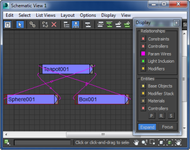

  2. Open the Schematic View dialog by clicking image on the main toolbar.
    Schematic View opens showing the scene nodes and the Display floater.
    Tip: If you don't see the Display floater, open it from the Display menu in Schematic View.
  3. On the Display Floater, click the Param Wires button to turn it on.
    Any wires between nodes appear as lines of the same color as the Param Wires button.

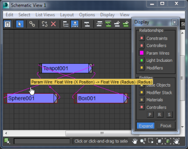

  4. Position the mouse cursor over one of the wires.
    The wired relationship appears in a tooltip.
  5. When you find a relationship you want to edit, double-click its wire.
    This opens the Parameter Wiring dialog with the wired parameters highlighted and the current settings active.

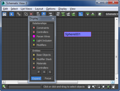

  3. On the Display floater, click the Param Wires button.
    Nothing changes because the parameter wiring is internal to the object. Its internal structure needs to be expanded to see the wiring.

  6. In all cases, once you've exposed enough parameters for the wires to appear, position the mouse cursor over a wire to see the relationship, and double-click a wire to open the Parameter Wiring dialog with the relationship highlighted.

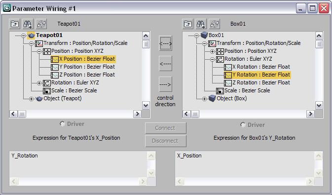

The dialog presents two tree views that display the animatable parameters of all of the visible objects in the scene. The names of the currently selected objects appear at the top. The tree views display the objects in the scene and allow you to select and wire all of the animatable parameters of the objects in the scene and the scene itself.
The tree views are color-coded to show existing wiring. A parameter with a wire controller assigned to it (either as the member of a two-way pair or as the driven parameter in a one-way wire) displays in red. When a wire-controlled parameter is selected, all of the parameters wired directly to it are displayed in green text in the other Tree View. In either case, if the parameter is inside a track that is not expanded, the enclosing track will display in red or green, so you can expand the tracks to find the wires.
Note: If you open the Parameter Wiring dialog by wiring two parameters, the tree views initially display only the selected objects, highlighting the parameters that you chose from the pop-up menus during the wiring procedure. If you want to expand the trees, to include all other animatable parameters in the scene, click Show All Tracks.
Note: Only parameters of compatible type can be connected. If incompatible parameters are selected, the connection type buttons are greyed out, and a tooltip indicates that the parameters are incompatible.

[transfer expression windows]
Underneath the parameter trees are the transfer expression windows. These expressions determine how a changes to each parameter affects the other. Usually one expression is the inverse of the other. (You can enter expressions for the two parameters that are not inverses of each other, but this is discouraged because then the result of the wiring will be different depending on which parameter you change first.)
When you first wire the parameters, the default expressions are simple 1-to-1 links between the parameters. You can edit the expressions in these windows. A valid expression yields a result of the correct type for its parameter. For example, if you link a parameter such as height (which contains a float value) to a parameter such as position (which contains a point3 value), your expressions must include conversions that produce the same output value type.
For more information on expression syntax, see the topic “Script Controllers” in the MAXScript Help.
For one-way wires, the expression window for the controlling parameter is unavailable, since there is no Wire controller assigned to it.
For two-way wiring, both transfer expression windows are enabled.
