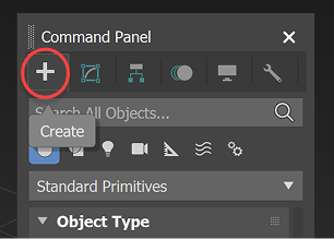

Found in the Command Panel, the Create panel provides the controls for creating objects. This is the first step in building a new scene in 3ds Max.
The Create panel in the Command panel.
Create panel

The Create panel groups the kinds of objects you create into seven categories. Each category has its own button. Within each category there can be several different subcategories of objects. A drop-down list lets you choose among object subcategories, and each kind of object has its own button, which you click to begin creation.
