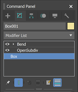

The modifier stack controls appear near the top of the Modify panel, just below the Modifier List. The modifier stack ("stack" for short) contains the accumulated history of an object, including its creation parameters and the modifiers applied to it. At the bottom of the stack is the original object. Above the object are the modifiers, in order from bottom to top. This is the order in which modifiers are applied to the object's geometry.
Object with two modifiers applied to it in the stack

The modifier stack is organized as follows:
At the bottom of the stack, the first entry always lists the object type. Click this entry to display the object's creation parameters so you can adjust them.
When you click to choose an entry in the modifier stack, its background highlights to show that the entry is current, and that the object's or modifier's parameters are available for adjusting, in rollouts that appear beneath the stack display.
Above the object itself are entries for object-space modifiers. Click a modifier entry to display the modifier's parameters so you can adjust them.
This section lets you go back to any modifier you've applied and adjust its effect on the object. You can also delete the modifier from the stack, canceling its effect.
The top of the stack shows which space warps and world-space modifiers the object uses. For example, if the object were bound to a Ripple space warp, an entry in the top section would read Ripple Binding.
To the left of each modifier in the stack is a light-bulb icon. When the bulb appears white, the modifier is applied to the stack below it. When the bulb appears gray, the modifier is turned off. Click to toggle the on/off state of the modifier.
If the modifier has sub-controls such as a center or a gizmo, the stack also shows a small plus/minus icon. Click this icon to open or close the hierarchy.
Opening a modifier's hierarchy to access sub-controls
When the hierarchy is open, you can select a sub-control, such as a gizmo, and then adjust it. The available sub-controls vary from modifier to modifier.
Objects that have a sub-object hierarchy, such as editable poly, also show a collapsible hierarchy in the modifier stack.
To work at a sub-object level, click the + icon to expand the hierarchy, then click to select the sub-object level. Controls for that particular level or type of sub-object appear in rollouts below the stack display.
Certain types of sub-objects display an icon at the right of the stack, to help you see which sub-object type you are adjusting.
Expanding an object's hierarchy to access sub-object levels
