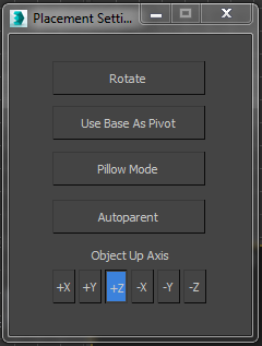

The Placement Settings dialog provides controls for modifying object movement when using Select And Place. To open the dialog, right-click the Select And Place button on the Main Toolbar.
Rotate
When on, dragging the object rotates it around the local axis specified with the Object Up Axis setting (see following), while preventing translation.
Use Base as Pivot
Uses the base of an object as the contact point with other objects. This is most useful for objects whose pivot is not already located in the base of the object.
For the purposes of this control, "base" is defined as the point on the object at which the "bottom" end of the specified Object Up Axis intersects the object surface. For example, a sphere's pivot is located at its center by default. So if you use Select And Place to position a sphere on another object, the bottom half of the sphere will fall under the object's surface because Select And Place uses the center as the base. But if you turn on Use Base As Pivot and set Object Up Axis to +Z (the default), Select And Place uses the intersection of the local –Z axis and the sphere's surface as the base instead.
Pillow Mode
Moves objects around each other with no intersection between them. This option is useful when moving objects over an uneven surface.
Note: Use Base as Pivot and Pillow Mode cannot be used at the same time.
Autoparent
Links objects in a hierarchical relationship. When this control is on, if you place an object in contact with another, the placed object becomes the child of the other object.
Object Up Axis
Specifies the local axis of the transformed object that is used to orient the object when moving it.
