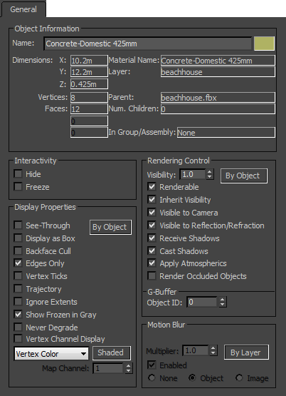

General Panel (Object Properties Dialog)
This panel of the Object Properties dialog displays general object information, as well as controls for rendering the object and displaying it in viewports.
Object Information group
This group displays information about the selected object, including the following:
Name
Shows the name of the object. When a single object is selected, you can edit this field to give the object a new name. When multiple objects are selected, this field shows "Multiple Selected," and cannot be edited.
Color
The color swatch shows the object's color. You can click it to display the Object Color dialog and select a different color.
Note: If the color swatch is black-and-white ( image ), the object color is set to By Layer and is controlled by the color of the layer to which the object belongs.
Dimensions
Displays the X, Y, and Z dimensions of the object's extents.
Vertices and Faces
Display the number of vertices and faces in the object. For shapes, these values are the values used if the shape is renderable. Faces for renderable shapes are generated only at rendering time.
Shape Vertices and Shape Curves
Appear only for shape objects. Shape Vertices is the number of vertices in the shape, and Shape Curves is the number of polygons. (Shape Curves is the value that appeared as "Polygons" in previous releases.)
These values can change over time: they are valid only for the current frame and the current view.
Parent
Displays the name of the object's parent in a hierarchy. Shows "Scene Root" if the object has no hierarchical parent.
Material Name
Displays the name of the material assigned to the object. Displays "None" if no material is assigned.
Num. Children
Displays the number of children hierarchically linked to the object.
In Group/Assembly
Displays the name of the group or assembly to which the object belongs. Displays "None" if the object is not part of a group.
Layer
Displays the name of the layer which the object is assigned to.
Interactivity Group
Hide
Hides the selected object or objects.
Hidden objects exist in the scene, but do not appear in the viewports or rendered images. To unhide hidden objects, use the Display panel or choose Tools > Display Floater.
Note: Objects residing on a hidden layer are automatically hidden, regardless of this setting.
Tip: The Layer Manager is the easiest way to hide groups of objects or layers.
Freeze
Freezes the selected object or objects.
Frozen objects appear in the viewports, but cannot be manipulated. To unfreeze frozen objects, use the Display panel or choose Tools > Display Floater.
Note: Objects residing on a frozen layer are automatically frozen, regardless of this setting.
Tip: The Layer Manager is the easiest way to freeze groups of objects or layers.
Display Properties group
Note: Most of these options are also available on the Display panel and by choosing Tools > Display Floater.
By Object/By Layer
Toggles between setting display properties on a per-object basis and at the layer level. When set to By Layer, the object display properties are unavailable; set the layer properties on the Layer Properties dialog.
Note: If multiple objects are selected and have different values for this setting, this button reads “Mixed.”
See-Through
Makes the object or selection translucent in viewports. This setting has no effect on rendering: it simply lets you see what is behind an object in a crowded scene, and especially to adjust the position of objects behind the see-through object. Default=off.
You can customize the color of see-through objects by using the Colors panel of the Customize > Customize User Interface dialog.
Keyboard shortcut (default): Alt+X
Display as Box
Toggles the display of selected objects, both 3D objects and 2D shapes, as bounding boxes. Produces minimum geometric complexity for rapid display in viewports. Default=off.
Backface Cull
Toggles the display of faces with normals that point away from the view. When on, you see through the wireframe to the backfaces. Applies only to wireframe viewports. Default=off.
Edges Only
Toggles the display of hidden edges and polygon diagonals. When on, only outside edges appear. When off, all mesh geometry appears. Applies to Wireframe viewport display mode, as well as other modes with Edged Faces turned on.
Note: This option is also available in the Display panel and by choosing Tools > Display Floater.
Vertex Ticks
Displays the object's vertices as tick marks. Default=off.
Trajectory
Displays the object's trajectory. Default=off.
Ignore Extents
When on, this object is ignored when you use the display controls Zoom Extents and Zoom Extents All.
Keyboard shortcut: No default, but you can customize it using the Keyboard panel of the Customize > Customize User Interface dialog.
Show Frozen in Gray
When on, the object turns gray in viewports when you freeze it. When off, viewports display the object with its usual color or texture even when it is frozen. Default=on.
Never Degrade
When on, the object is not subject to adaptive degradation.
Vertex Channel Display
For editable mesh, editable poly, and editable patch objects, displays the assigned vertex colors in viewports. The drop-down list lets you choose to display Vertex Color, Vertex Illumination, Vertex Alpha, Map Channel Color, or Soft Selection Color. Default=off.
You can assign vertex colors at all sub-object levels except Edge.
Map Channel
Sets the map channel for the vertex color. Available only when the Map Channel Color option is active.
Shaded
When on, shaded viewports add shading to the vertex coloring. When off, colors are unshaded. Default=off.
Rendering Control group
By Object/By Layer
Toggles between setting rendering controls on a per-object basis and at the layer level. When set to By Layer, the object rendering control settings are unavailable; set the layer properties on the Layer Properties dialog.
Visibility
Controls the rendered visibility of the object. At 1.0, the object is fully visible. At 0.0, the object is completely invisible when rendered. Default=1.0.
You can animate this parameter; doing so assigns a Visibility track to the object. By default this track uses a Bezier float controller.
Renderable
Makes an object or selected objects appear or disappear from rendered output. Nonrenderable objects don't cast shadows or affect the visual component of the rendered scene. Like dummy objects, nonrenderable objects can manipulate other objects in the scene.
For lights, this is the only available control in the Rendering Controls group. Making a light non-renderable effectively turns it off.
Shape objects have the Renderable option turned on by default. In addition, each shape has an Enable In Renderer parameter. When both checkboxes are on, the shape appears in rendered output. If the Renderable object properties setting is off, the shape is not renderable, regardless of the state of its local Enable In Renderer checkbox.
If you apply a modifier that converts the shape into a mesh object, such as a Lathe modifier or Extrude modifier, the shape automatically becomes renderable regardless of the state of its local Enable In Renderer setting.
Inherit Visibility
Causes the object to inherit a percentage of the visibility of its parent (as determined by the parent's Visibility track in Track View). When a group parent is assigned a visibility track, Inherit Visibility is automatically turned on for all children in the group. The children will have the maximum visibility of the parent. Transparent materials and hidden objects have no effect on this function.
Visible to Camera
When on, the object is visible to cameras in the scene. When off, cameras do not view this object; however, its shadows and reflections are rendered. Default=on.
Visible to Reflection/Refraction
When on, the object has “secondary” visibility: it appears in rendered reflections and refractions. When off, the object does not appear in rendered reflections or refractions. Default=on.
Note: An object can have Visible To Camera on but Visible To Reflection/Refraction off, in which case the object renders in the scene but does not appear in reflections or refractions.
Receive Shadows
When on, the object can receive shadows. Default=on.
Cast Shadows
When on, the object can cast shadows. Default=on.
Apply Atmospherics
When on, atmospheric effects are applied to the object. When off, atmospheric effects do not change the rendered appearance of this object. Default=on.
Render Occluded Objects
Allows special effects to affect objects in the scene that are occluded by this object. The special effects, typically applied by plug-ins such as Glow, use G-buffer layers to access occluded objects. Turning on this control makes the object transparent for the purposes of special effects. This makes no difference when you render to most image files. When you render to either the RLA or RPF file format, however, occluded objects appear with the effect applied on their designated G-buffer layer. Default=off.
G-Buffer group
Allows you to tag an object as a target for a render effect based on the G-buffer channel. Assigning the object a nonzero ID creates a G-buffer channel that can be associated with a render effect.
The Object ID property is also used with the Multi/Sub-Map shader, and can be displayed in the Rendered Frame Window when rendering to RLA and RPF formats.
Object ID
Setting Object ID to a nonzero value means that the object will receive the rendering effects associated with that channel in Render Effects and the post-processing effects associated with that channel in Video Post.
To save the channel data with the rendering, render to either the RLA or RPF file format.
Motion Blur group
By Object/By Layer
Toggles between setting motion blur properties on a per-object basis and at the layer level. When set to By Layer, the motion blur settings are unavailable; set the layer properties on the Layer Properties dialog.
Multiplier
Affects the length of the motion-blur streak.
If you choose either form of motion blur here in the Object Properties dialog, you must also choose to apply that type of blur in the Render Setup dialog.
The rendering speed of object motion blur depends on the complexity of the geometry to which it's assigned. The rendering speed of image motion blur depends on the amount of rendered screen space taken up by the blurring object. In most cases image motion blur renders more quickly. Object motion blur renders more quickly when applied to very simple objects, and image motion blur renders more slowly when the object takes up a lot of screen space, and moves all the way across the screen in a single frame.
Changing the Object Blur Multiplier value.
Enabled
When on, enables motion blur for this object. When off, motion blur is disabled regardless of the other blur settings. Default=on.
You can animate the Enabled checkbox. The main use of animating Enable is to apply motion blur over only a limited range of frames. This can save a tremendous amount of time when you are rendering an animation.
You can enable motion blur for lights and cameras. Moving lights and cameras do not generate motion blur with the default scanline renderer.
