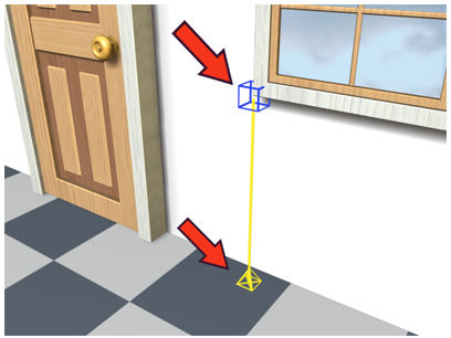

Using a tape helper to measure the distance from floor to window frame.

  1. Click Tape and drag from one point to create the tape, and then drag to a second point and release the mouse button to create the target.
    The distance between tape and target appears in the Length field. The number in the Length field is gray to indicate that this is a read-only measurement.
