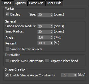

Setting Snap Options
You can access a number of snap features from the Options tab of the Grid And Snap Settings dialog. Right-click any of the snap buttons on the main toolbar to display the Grid And Snap Settings dialog or choose Tools menu (or Scene menu if using the Alt menu system) > Grids And Snaps > Grid And Snap Settings, then click the Options tab.
Display and General Settings
Marker settings
Determine the size of the snap cursor. To prevent the snap cursor from appearing, turn off Display.
Snap Radius settings
Determines how close the cursor needs to approach a snap point before the snap preview or actual snap takes place. These are global settings, affecting all snap interactions, and are measured in terms of the pixels in a "search region" around the active point of the cursor.
Snap to Frozen Objects
Normally, if an object is frozen you can't snap to it; this option lets you snap to frozen objects.

Translation Options
By default, the Use Axis Constraints option is off.
As of 3ds Max 2011, buttons on the Axis Constraints toolbar update interactively, depending on which portion of the gizmo or geometry you use to move the object.
The Translation group also lets you toggle display of a rubber band line between the start and end points during a snap operation.
