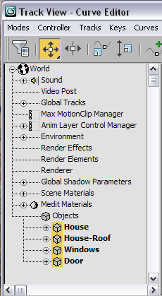

Track View provides sophisticated methods to edit your animation tracks. In addition, its Hierarchy list displays all objects in the scene by name and hierarchy. Using Track View, you can select any object in the scene by clicking its object icon in the Hierarchy list.
You can use Track View selection features in both the Curve Editor and the Dope Sheet. This procedure illustrates usage of the Curve Editor; the same methods work in the Dope Sheet.
To open Track View and display and select objects:
You can make the following kinds of selections:
Shift, and click another object elsewhere in the list.Ctrl while clicking. Ctrl lets you toggle individual items' selection status without deselecting others in the list.Alt, right-click the object's cube icon—keep the right mouse button held down—and choose Select Children from the menu. Or simply double-click the object's cube icon.You can open a Track View window for the sole purpose of selecting objects by name. Shrink the window until only a portion of the Hierarchy appears, and then move the window to a convenient area on your screen.
