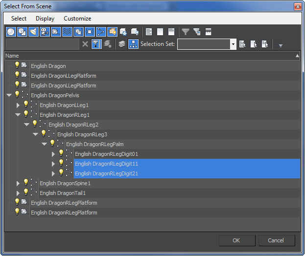

This dialog, named Select From Scene or Select Objects in most contexts, lets you select or designate objects by choosing them from a list of all objects currently in the scene.

Select From Scene is a modal, read-only version of the Scene Explorer; you can’t use it to change object properties such as name and color. Other differences between Select From Scene and Scene Explorer include:
- To select a single object and close the dialog, simply double-click the object’s list entry.
- The dialog is modal, so there is no automatic synchronization between highlighted items in the list and selection of the corresponding objects in the scene. To make a selection, first use the dialog to highlight the objects to be selected, then click OK to close the dialog and select the objects.
- Because Select From Scene doesn't enable dragging listed items, you cannot use it to edit hierarchies or layer contents. However, you can create new layers, to which any selected objects are then assigned.

The Select From Scene dialog opens. By default, it lists all objects in the scene, displaying any hierarchies as collapsible branches. Currently selected objects are highlighted in the list.
Choose one or more objects in the list by doing one of the following:
- To select a single object and close the dialog, double-click the object name.
- Drag, or click and then
Shift +click to select a contiguous range of objects or Ctrl +click to select noncontiguous objects.
- In the field above the list, type a search phrase. As you type, all matches for the current phrase are highlighted in the list. To highlight only objects whose case matches the search phrase exactly, turn on Find Case Sensitive (from the Select menu) .
