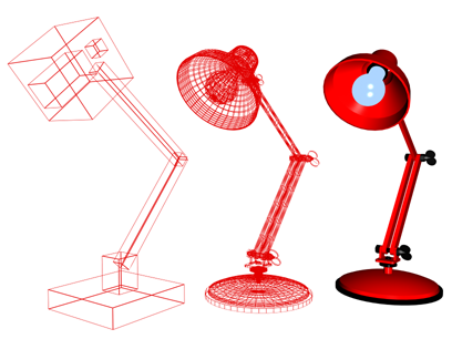

You can choose from multiple options to display your scene. You can display objects as simple boxes, or render them with smooth shading and texture mapping. If you want, you can choose a different display method for each viewport.
Box display, wireframe display, and smooth shading
Tip: If you want to display and render an individual object as wireframe, you can use a Standard or Raytrace material and set its shader to Wire. Or, to display an individual object to display as a box, select the object and choose Display as Box on the Display properties rollout on the display panel.
