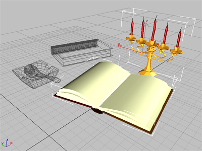

When a viewport is set to Wireframe, selected objects are shaded so you can visualize them more clearly. All other objects in the scene appear in wireframe.
Shade Selected also works when viewport display is set to Bounding Box (the Bounding Box option is available only for Nitrous viewports).
Selected objects shaded in a wireframe viewport
Selected object shaded in a bounding-box viewport
