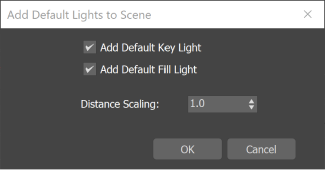

  5. On the Add Default Lights To Scene dialog, toggle Add Default Key Light, Add Default Fill Light, or both. Click OK.

Screencapture of the Add Default Lights to Scene modal.
When on, adds the default key light to the scene. The key light is in front of the scene and to the left. The key light becomes an omni light with the name, DefaultKeyLight. Default=on.
When on, adds the default fill light to the scene. The fill light is behind the scene and to the right. The fill light becomes an omni light with the name, DefaultFillLight. Default=on.
Distance Scaling
Affects how far the lights are placed from the origin (0,0,0). The default value leaves the scene's lighting unchanged. Larger values move the lights farther away, dimming the scene, and smaller values move them closer, brightening the scene. Default=1.0. Range=0.0 to 1000.0.
