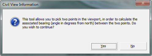

When you choose Measure Bearing, Civil View prompts you to choose the points to measure.

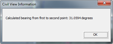

Click Yes, then in a viewport, click the two points. After you pick the points, Civil View displays the bearing that they indicate.
