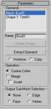

Parameters rollout
Operands group
[list of operands]
Lists all operands in the compound object. The first operand is the mesh object, and any number of shape-based operands can follow.
Name
If you select an object in the list, its name is displayed here. You can edit the field to change the object name.
Delete Shape
Remove selected shapes from the compound object.
Extract Operand
Extracts a copy or an instance of the selected operand. Choose an operand in the list window to enable this button.
Instance/Copy
Lets you specify how the operand is extracted. It can be extracted either as an instance or a copy.
Operation group
These options determine how the shape is applied to the mesh.
Cuts the shape out of the mesh object's surface.
Merge
Merges the shape with the surface of the mesh object.
Invert
Reverses the effect of Cookie Cutter or Merge. With the Cookie Cutter option, the effect is obvious. When Invert is off, the shape is a hole in the mesh object. When Invert is on, the shape is solid and the mesh is missing. When you're using Merge, Invert reverses the sub-object mesh selection. As an example, if you merge a circle shape and apply a Face Extrude, the circular area is extruded when Invert is off, and all but the circular area is extruded when Invert is on.
