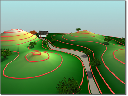

The Terrain compound object creates planet surfaces from contour-line data.
To produce a terrain, you select editable splines representing elevation contours and then click Terrain, whereupon 3ds Max generates a mesh surface over the contours. You can also create a "terraced" representation of the terrain object so that each level of contour data is a step, resembling traditional study models of land forms.
Using contours to build a terrain:
Inset left: The contours
Inset right: The terrain object
Main: Terrain object used as the basis of a landscape
You can import an AutoCAD drawing file to use as contour data. When you do so, 3ds Max names each object based on the AutoCAD object's layer, color, or object type, appending a number to each name. For example, an AutoCAD object on the layer BASE becomes an object named BASE.01. See Importing DWG Files for more information.
After you import or create the contour data, select the objects, and click the Terrain button, 3ds Max creates a new triangulated mesh object based on the contour data. The name of the first selected spline becomes the name of the terrain object. Other splines in the selection are treated according to the previously set Reference, Move, Copy, or Instance selection in the Pick Operand rollout, described below.

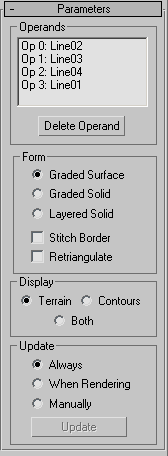

Parameters rollout
Operands group
[list of operands]
Displays the current operands. Each operand is listed as "Op" followed by a number and the name of the object that is being used as the operand. The operand name comprises layer, color, or object type name plus a numeric suffix.
Use standard mouse-based methods to highlight list members: Click to highlight a single entry; drag or Shift +click to highlight a range; Ctrl +click to toggle highlighting of a single entry without changing other entries’ status.
Delete Operand
Deletes highlighted entries in the Operands list.
Form group
Stitch Border
When on, suppresses the creation of new triangles around the edges of terrain objects when edge conditions are defined by splines that are not closed. Most terrain forms display more reasonably when this is turned off.
Retriangulate
The basic Terrain algorithm tends to flatten or notch contours when they turn sharply upon themselves. A typical situation in which this may happen is when a narrow creek bed is described with contours; the resulting form may look more like a series of cascades at each elevational contour, rather than a smoothly descending ravine. When Retriangulate is checked, a somewhat slower algorithm is used that follows contour lines more closely. This may be particularly evident in the Layered Solid display mode. For additional precision, try using Retriangulate in conjunction with horizontal interpolation.
Display group
Update group
The items in this group box determine when 3ds Max recalculates the projection for the terrain object. Because complex terrain objects can slow performance, you can use these options to avoid constant calculation.
Update
Updates the terrain object. This button is not enabled only when Always is the active option.

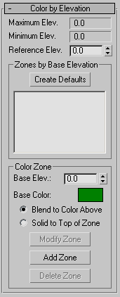

Color by Elevation rollout
Maximum Elev.
Displays the maximum elevation in the Z axis of the terrain object. 3ds Max derives this data from the contour data.
Minimum Elev.
Displays the minimum elevation in the Z axis of the terrain object. 3ds Max derives this data from the contour data.
Reference Elev.
This is the reference elevation, or datum, that 3ds Max uses as a guide for assigning colors to zones of elevation. After entering a reference elevation, click the Create Defaults button. 3ds Max treats elevations above the reference elevation as solid land and those below the reference elevation as water.
If you enter a value no greater than the minimum elevation in the object, 3ds Max divides the range between the reference and minimum elevations into five color zones: dark green, light green, yellow, purple, and light gray.
If you enter a value between the minimum and maximum elevations, 3ds Max creates six color zones. Two zones (dark blue and light blue) are used for elevations below the reference elevation. These are considered to be under water. One zone (dark yellow) is used for a narrow range around the reference elevation. Three zones (dark green, light green, light yellow) are used for elevations above the reference elevation.
If you enter a value at or above the maximum elevation, 3ds Max divides the range between the minimum and reference elevations into three zones (dark blue, medium blue, light blue).
Zones by Base Elevation group
Create Defaults
Creates elevation zones. 3ds Max lists the elevation at the bottom of each zone, referenced to the datum (the reference elevation). 3ds Max applies the color of the zone at the base elevation. Whether the colors blend between zones depends on your choice of the Blend to Color Above or Solid to Top of Zone option.
Color Zone group
The items in this group box assign colors to elevation zones. For example, you might want to change levels of blue to indicate the depth for water. Your changes in the Color Zone area don't affect the terrain object until you click the Modify Zone or Add Zone button.
Base Elev
This is the base elevation of a zone to which you assign color. After entering a value, click Add Zone to display the elevation in the list under Create Defaults.
Base Color
Click the color swatch to change the color of the zone.
Modify Zone
Modifies selected options of a zone.
Add Zone
Adds values and selected options for a new zone.
Delete Zone
Deletes a selected zone.
