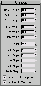

Parameters rollout
Back/Side/Front Length
Specify the length of each of the three sides.
Back/Side/Front Width
Specify the width of each of the three sides.
Height
Specifies the overall height of the object.
Back/Side/Front Segs
Specify the number of segments for a specific side of the object.
Note: The object's dimensions (Back, Side, Front) are labeled as though it were created in the Top or Perspective viewports, and seen from the front in world space.
Width/Height Segs
Set these to specify the number of segments for the overall width and height of the object.
Generate Mapping Coords
Sets up the required coordinates for applying mapped materials to the object. Default=on.
Real-World Map Size
Controls the scaling method used for texture mapped materials that are applied to the object. The scaling values are controlled by the Use Real-World Scale settings found in the applied material's Coordinates rollout. Default=off.
