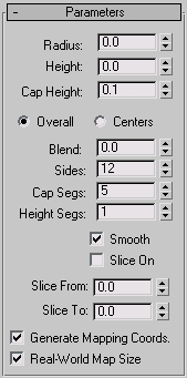

Parameters rollout
Radius
Sets the radius of the spindle.
Height
Sets the dimension along the central axis. Negative values create the spindle below the construction plane.
Cap Height
Sets the height of the conical caps. The minimum value is 0.1; the maximum value is ½ the absolute value of the Height setting.
Overall/Centers
Determines what the Height value specifies. Overall specifies the overall height of the object. Centers specifies the height of the midsection of the cylinder, not including its conical caps.
Blend
When greater than 0, creates a fillet where the caps meet the body of the spindle.
Sides
Sets the number of sides around the spindle. Higher numbers shade and render as true circles with Smooth on. Lower numbers create regular polygonal objects with Smooth off.
Cap Segs
Sets the number of concentric divisions along the center of the spindle's top and bottom.
Height Segs
Sets the number of divisions along the spindle's major axis.
Smooth
Blends the faces of the spindle, creating a smooth appearance in rendered views.
Slice On
Turns on the Slice function. Default=off.
When you create a slice and then turn off Slice On, the complete spindle reappears. You can therefore use this checkbox to switch between the two topologies.
Slice From, Slice To
Sets the number of degrees around the local Z axis from a zero point at the local X axis.
For both settings, positive values move the end of the slice counterclockwise; negative values move it clockwise. Either setting can be made first. When the ends meet, the whole spindle reappears.
Generate Mapping Coords
Sets up the required coordinates for applying mapped materials to the spindle. Default=on.
Real-World Map Size
Controls the scaling method used for texture mapped materials that are applied to the object. The scaling values are controlled by the Use Real-World Scale settings found in the applied material's Coordinates rollout. Default=off.
