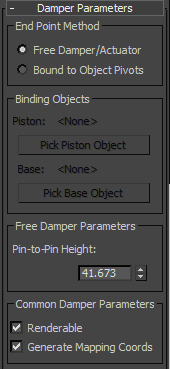

Interface
End Point Method group
Free Damper/Actuator
Choose this when using the damper as a simple object that’s not bound to others or used in a dynamics simulation.
Bound to Object Pivots
Choose this option when binding the damper to two objects, using the buttons described next.
Binding Objects group
Use these controls to pick the objects to which the damper is bound. To complete the binding, you must select two binding objects, and then click Bound to Object Pivots.
Piston (label)
Displays the name of the object bound to the piston of the damper.
Pick Piston Object
Click this button and then select the object to be bound to the piston of the damper.
Base (label)
Displays the name of the object bound to the base of the damper.
Pick Base Object
Click this button and then select the object to be bound to the base of the damper.
Free Damper Parameters group
Pin-to-Pin Height
Use this field/spinner to specify the distance between the bottom center of the base and the top center of the piston when the damper is not bound.
Common Damper Parameters group
Renderable
When on, the object appears in the rendering; when off, the object does not appear.
Material IDs are assigned to the damper object as follows:
1: Base
2: Main housing
3: Piston
4: Boot Stop (appears only if you enable Boot Parameters)
5: Boot (appears only if you enable Boot Parameters)
