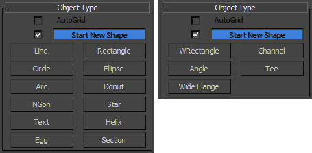

Object Type rollout (Splines and Extended Splines)
AutoGrid
Lets you automatically create objects on the surface of other objects by generating and activating a temporary construction plane based on normals of the face that you click.
For more information, see AutoGrid.
Start New Shape
A shape can contain a single spline or it can be a compound shape containing multiple splines. You control how many splines are in a shape using the Start New Shape button and checkbox on the Object Type rollout.
The checkbox next to the Start New Shape button determines when new shapes are created. When the option is on, 3ds Max creates a new shape object for every spline you create. When off, splines are added to the current shape until you click the Start New Shape button.
Shape Selection buttons
Lets you specify the type of shape to create.
