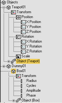

To put other kinds of objects in the ring:
You can use either version of Track View: Curve Editor or Dope Sheet.
  1. In the Track View Controller window, click the name of Object component of the object to put in the ring.
    The name highlights.
  2. Still in the Controller window, right-click and choose Copy from the menu.
  3. Highlight the Object component of one of the ring array boxes.
  4. Right-click and choose Paste.
  5. In the Paste dialog, choose Copy or Instance. Optionally, to replace all the boxes with the copied object, turn on Replace All Instances. Click OK.
    The box or boxes are replaced with the copied object.
    Tip: To see the replacement objects, you might need to refresh the viewports.
