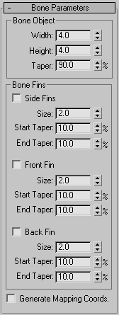

Bone Parameters rollout (creation and modification time)
These controls change the appearance of the bones. They are also available on the Fin Adjustment Tools rollout of the Bone Tools dialog.
Width/Height
The bone's respective sizes.
Taper
Setting Taper to 0 produces a box-shaped bone. Higher values pinch the bone where it joins its child bone, while lower values expand that end of the bone.
Bone Fins
Use the checkboxes to toggle fins on the respective sides of the bones, and the numeric settings to control the fins' size and taper settings.
Generate Mapping Coords
Automatically creates mapping coordinates on the bones. If you make bones renderable and apply materials, they use these mapping coordinates.
