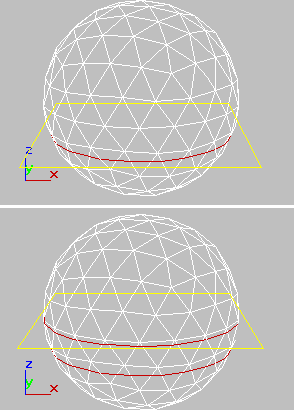

To create multiple slices:
  1. Select an editable mesh.
  2. On the image Modify panel, choose the object's Edge (or Face, Polygon, or Element) sub-object level.
  3. image When working at the Face, Poly, or Element level, select one or more sub-objects. At these levels, slice affects only selected sub-objects; at the Vertex and Edge levels, it affects the entire mesh.
  4. In the Cut And Slice group, click the Slice Plane button.
  5. Position and rotate the Slice Plane gizmo to where you want the first slice.
  6. Click the Slice button. The object is sliced.
  7. If you want, move the Slice Plane to a second position and click the Slice button again.
  8. Click the Slice Plane button again to turn it off and see the results.
    Tip: For a better look at the resulting mesh, turn off Edges Only on the Display panel > DisplayProperties rollout.
    Slice gizmo placed for first slice (top) and second slice (bottom)
