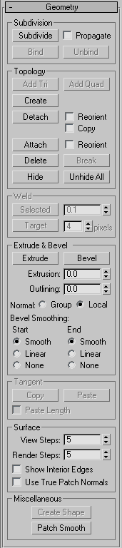

Geometry rollout
See Geometry Rollout (Patch) for detailed descriptions of these controls.
