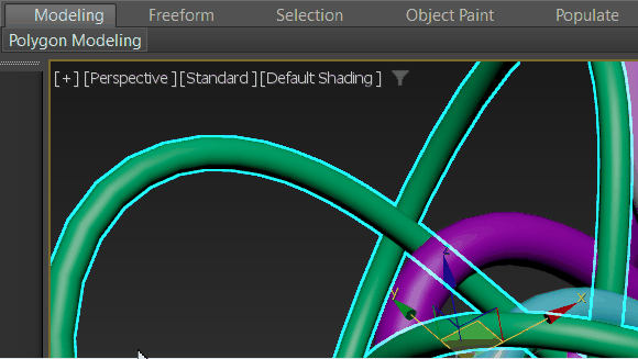

To use the viewport statistics display:
  1. Choose Customize menu > Viewport Configuration dialog > Statistics panel.
  2. Activate the viewport in which to display statistics.
  3. Toggle the statistics display by pressing 7 or right-clicking the viewport label and choosing xView > Show Statistics.
Interface
You can customize the viewport statistics by turning on and off options on the Statistics panel of the Viewport Configuration dialog. The following statistics reflect all options turned on.
The first column lists the statistics for the entire scene, while the second only refers to the selected objects.
