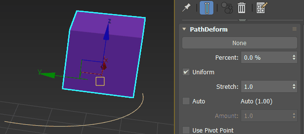

Using a Path to Deform an Object
Use the object-space PathDeform modifier when you want to keep an object in place while deforming to a path. When you want to move an object to a path while keeping the path in the same world space, use the world-space PathDeform modifier instead.
To use the PathDeform modifier, click the Pick Path button immediately after applying it, and then select a shape or curve consisting of a single open or closed spline. Once the object is assigned to the path, you can adjust the parameters to deform or animate the object along a gizmo copy of the path.
Interface
Path Deform rollout
Pick Path button
The Pick Path button
Click to select a spline or NURBS curve to use as the path. The gizmo that appears is shaped like the path and is aligned with the local Z axis of the object. Once you assign the path, you can adjust the deformation of the object using the remaining controls in this rollout. The path may contain multiple curves.
Note: The Pick Path button appears in the rollout labelled as None and takes the name of the path once one is selected.

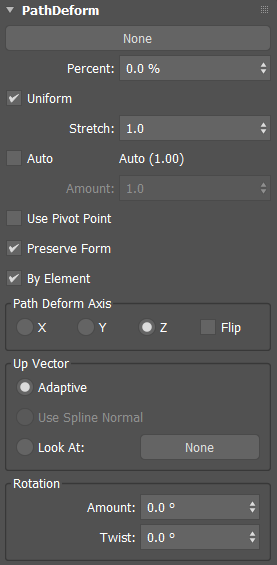

Percent
Sets the percentage along the spline path that will be used as the start of object deformation.
Uniform
Bases the percent calculation on the actual spline distance rather than interpolated between knots.
Stretch
Sets how much to stretch the source object along the path.
Auto
Uses the indicated value to stretch the source object across the entire spline length.
Amount
Sets the amount to stretch.
Use Pivot Point
Uses the pivot point of the object as the deformation reference point.
Preserve Form
When enabled, makes the object follow the spline while maintaining its shape rather than conform.

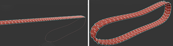

By Element
When enabled, deforms each mesh element on the model independently along the path. This option can help prevent a mesh with multiple elements from becoming deformed or distorted, for example when modeling tank treads.
By Element option enabled (right)
When enabled, the averaged center of the element is used to position the element on the path. When disabled, the pivot location of the mesh is used to position the object along the path.
Path Deform Axis group
X
Sets X as the deforming axis along the spline.
Y
Sets Y as the deforming axis along the spline.
Z
Sets Z as the deforming axis along the spline.
Flip
Reverses the gizmo path 180 degrees about the specified axis.
Up Vector group
Note: The up vector should be perpendicular to the path of travel for the deformation path. If a Freehand Spline object with normals is present, the Use Spline Normal option should generally be used.
Adaptive
Automatically calculates the up vector for the spline.
Use Spline Normal
Uses the spline normal as the up vector.
Look At
Sets the up vector to point at a selected object. To do this, click the button to the right and select an object from the scene.
Rotation group
Amount
Sets the amount of rotation constant along the length.
Twist
Twists the object about the path.

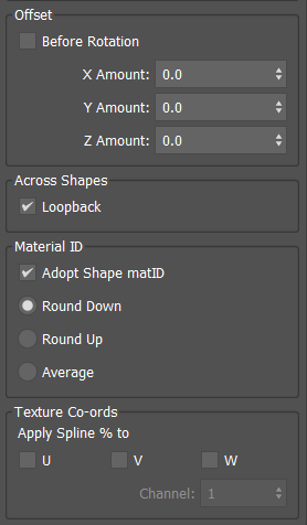

Offset group
Before Rotation
When enabled, applies the offset before performing rotation operations.
X Amount
Sets the offset value along the X axis.
Y Amount
Sets the offset value along the Y axis.
Z Amount
Across Shapes group
Loopback
When enabled, makes the deformed object loop back to the beginning of the spline. When disabled, the deformed object continues along the direction of the first or last knot.
Material ID group
Adopt Shape matID
Makes the object adopt the material ID(s) of the underlying spline(s).
Round Down
In the case of multiple splines, takes the lowest value.
Round Up
In the case of multiple splines, takes the highest value.
Average
In the case of multiple splines, takes the average value of the highest and lowest, rounding down.
Texture Coordinates group
Apply Spline % to
Allows the overwriting of UVW coordinates based on the percentage along the path of an object's vertex. Click to select the desired coordinates to be overwritten.
Channel
Specifies the target UVW channel.

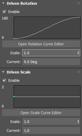

Driven Rotation and Scale rollouts
These features provide the ability to specify the rotation and scale of the deformed object along the spline's path.
The drawn curve represents the calculated value along the path of the driving spline. The 0% value will always equal 0 degrees of rotation/scale.
Driven Rotation rollout
Enable
Enables custom rotation along the spline.
Open Rotation Curve Editor
Opens the Rotation Curve editor where the curve can be edited using standard controls.
Scale
Multiplies all rotation values with the specified scale.
Current
Displays the current rotational angle for the deformed object along the spline. This field is not editable.
Driven Scale rollout
Enable
Enables custom scale along the spline.
Open Scale Curve Editor
Opens the Scale Curve editor where the curve can be edited using standard controls.
Scale
Multiplies all scale values.
Current
Displays the current scale for the deformed object along the spline. This field is not editable.
