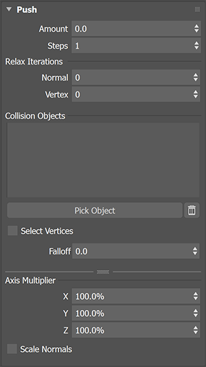

Interface
Push
- Amount: Sets the distance in display units by which vertices are moved with respect to the object center. Use a positive value to move vertices outward, or a negative value to move vertices inward.

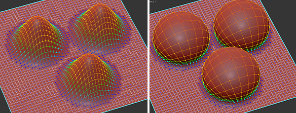

- Steps: Increases calculation time, but captures a more accurate end result. The normals will be calculated each step against the Amount value.
The example image on the left shows the Push modifier Amount being increased with Soft Selection on and the Steps at 0. The image on the right shows what happens when you increase the Steps to 50.
Relax Iterations
- Normal: Relaxes the mesh based on its normals, preventing issues, such as self-intersection, and ensuring a cleaner appearance.
- Vertex: Relaxes the mesh based on vertex position.
Collision Objects

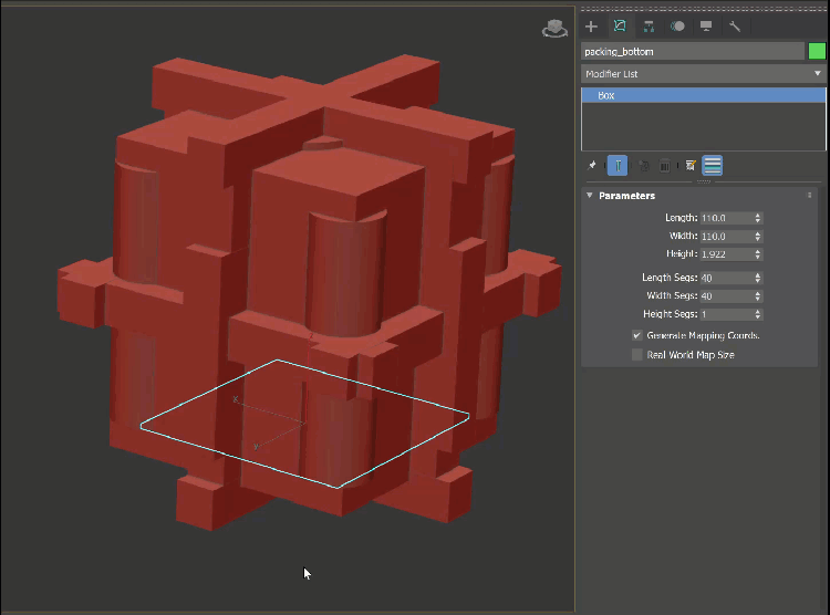

- Use the Pick Object button in the modifier to select objects in the Scene Explorer or Viewport that the mesh will recognize as it pushes out from its original location. When the mesh collides with these objects, it stops moving in that direction.
- Select Vertices: When active, vertices that have had their push amount limited by a Collision Object will be selected and passed up the stack.
- Falloff: Adjusts the falloff distance from the vertices that are chosen when Select Vertices are active. On the Push modifier, these vertices will be shaded in the viewport.
Tip: Use the checkbox in the Collision Objects list to temporarily "turn off" an item from being used to limit the push amount. The Vertex Normals will shoot out and find the Closest Vertex to match to on the reference object.
Note: Gargoyle model from QuadriFlow
In the example above, we used the Push modifier 's Collision Objects feature with other geometry to create a "packing foam-like" shape around a gargoyle statue.
Axis Multiplier
- Use the X, Y, and Z values to scale the object's mesh data.
- Scale Normals: When active, instead of scaling the object's mesh data, you will instead limit how much the push amount can affect the axis between a value of 0 (no effect) to 100 (complete effect).

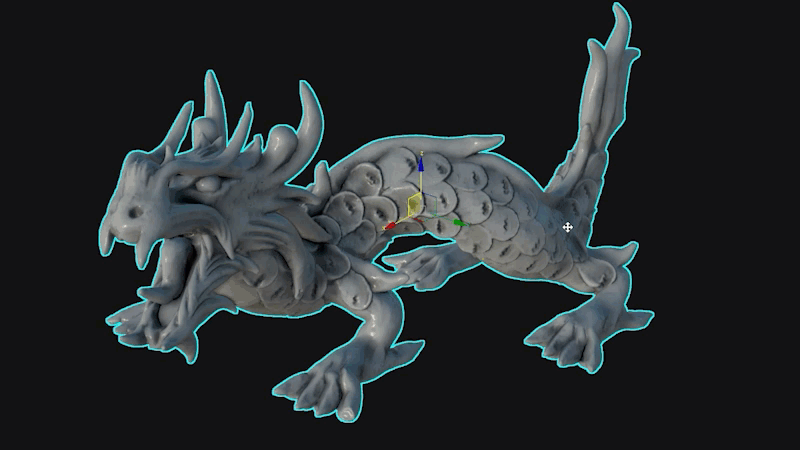

- If the effect causes self-intersecting results, use the Relax Iterations Normal (and/or Vertex) to "smooth out" the push and restore some of your object's form.
Note: xyzrgb_dragon model by Stanford 3D Scanning Repository
