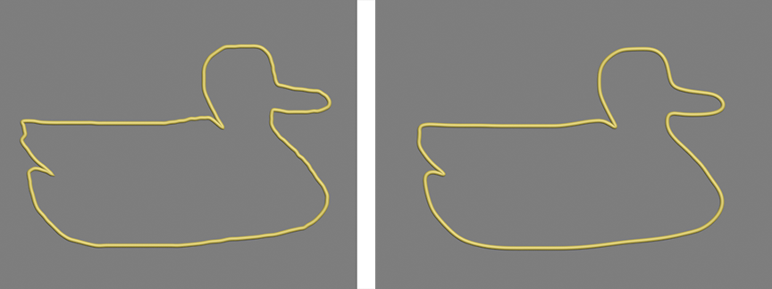

Freehand spline illustration of a ducky, before (left) and after (right) application of Spline Relax modifier.
