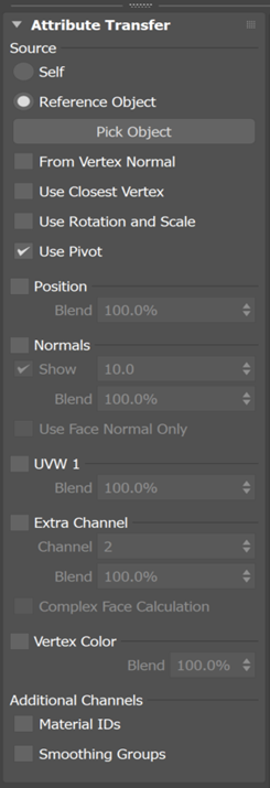

The Attribute Transfer modifier interface is organized by Source, which includes Self mode or Reference Object mode. You can then selection the mesh data you would like transferred.
Source
You can adjust the position, normals, UVs, and vertex colors using parameters like From Vertex Normal, Use Closest Vertex, Use Rotation and Scale, or Use Pivot.
Transfer Options
Note: You can pass data up through the modifier stack in order to limit the changes through the Attribute Transfer modifier.

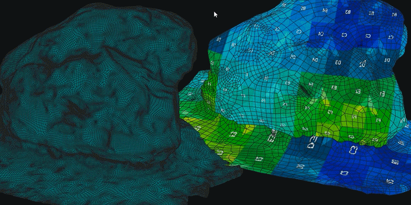

Position lets you change the vertex positions of an object to reflect the surface of a reference object. This adjustment doesn't move the object's location in the scene.
Tip: This feature is useful for creating retopology base meshes, aligning segmented meshes, making proxy objects for simulations, and efficiently matching blendshapes.

To use the Attribute Transfer modifier for UVs:
  1. With at least two objects in your scene, select the non-UV'd object, go to the image Modify panel > Modifier List > Object-Space Modifiers, and select the Attribute Transfer modifier.
  2. Change the Source to Reference Object.
  3. Select image and the object whose UVs you want to transfer from.
  4. In the modifier, select the UVW 1 checkbox along with Use Rotation and Scale.
  5. Your UVs are now transferred.
