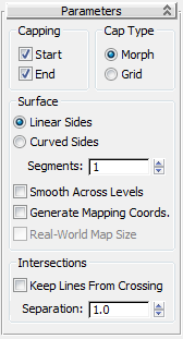

Parameters rollout
Start
Caps the end with the lowest local Z value (bottom) of the object. When off, the bottom is open.
End
Caps the end with the highest local Z value (top) of the object. When off, the end is left open.
Cap Type
Choose the capping method:
Surface
The interpolation method used between levels:
Segments
The number of intermediate segments between each level.
Smooth Across Levels
Controls whether smoothing groups are applied to the sides of a beveled object. Caps always use a different smoothing group than the sides.
Generate Mapping Coordinates
When on, mapping coordinates are applied to the beveled object.
Real-World Map Size
The scaling method used for texture mapped materials that are applied to the object. The scaling values are controlled by the Use Real-World Scale settings found in the applied material's Coordinates rollout. Default=on.
Keep Lines From Crossing
Prevents outlines from crossing over themselves. This is accomplished by inserting extra vertices in the outline and replacing sharp corners with flat line segments.
Using Keep Lines From Crossing:
Left: Off
Right: On
Bevel works best with rounded shapes or shapes with corners greater than 90 degrees. Acute angles (less than 90 degrees) produce extreme bevels and often overlap nearby edges.
Separation
Sets the distance to be maintained between edges. The minimum value is 0.01.
