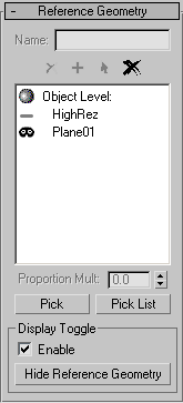

Reference Geometry Rollout (Projection Modifier)
On the Reference geometry rollout, you can create named sub-object selection sets, and associate them with high-resolution geometry.
Interface
Name
Lets you enter a name for the current set of selected sub-objects.
image Delete
Click to delete the sub-object selection set whose name is highlighted in the list.
image Add
Click to add the named sub-object selection set to the list.
Keyboard shortcut: Enter.
image Select
Click to select the sub-objects in the selection set whose name is highlighted in the list.
image Delete All
Click to delete all named sub-object selection sets in the list.
Reference geometry window
This window shows a list of named sub-object selection sets, and the high-resolution source geometry with which they're associated. If you have picked a high-res object at the object level, it also shows “Object Level” followed by the name of the source object.
Proportion Multiplier
When Proportional is chosen for sub-object normal bump mapping in the Projection Mapping group of the Objects To Bake rollout for Render To Texture, this value multiplies the default size of the normal bump map. Range=0.0 to 2.0. Default=1.0.
For example, if Proportional rendering of a sub-object were to render a sub-object selection at 16 x 16 pixels, changing Proportion Multiplier to 2.0 would change the size of the normal bump map to 32 x 32 pixels.
This control is unavailable unless a sub-object selection is active.
Pick
To associate high-res geometry with the current selection, click Pick to turn it on, then click a source object in a viewport.
Pick List
To associate high-res geometry with the current selection, click Pick List, then use the Add Objects dialog, which works like the Select From Scene dialog, to choose a source object.
Display Toggle group
The Display Toggle group is useful when you want to compare the hi—res to your low-res geometry. You can quickly toggle between your low-res geometry and your hi-res geometry to compare versions. You can show selected or all hi-res geometry.
Enable
When on, makes it possible to show or hide reference geometries. Default=off.
Hide Reference Geometry/Hide Working Geometry
When Enabled is on, click Hide Reference Geometry to hide your hi-res geometry. Conversely, click Hide Working Geometry to hide your low-res geometry. You can also selectively show and hide high-res geometries in your Pick List. Click Off image to hide a geometry. Click Hide image to show a geometry.
