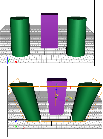

Top: Original objects
Bottom: Single modifier applied to objects

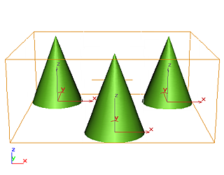

Original objects

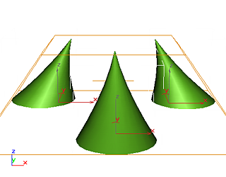

Single modifier applied to all objects

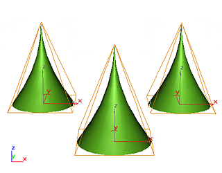

Single modifier applied with Use Pivot Points activated
