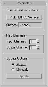

  6. In the Parameters rollout, turn on Pick NURBS Surface, and then click the NURBS projection surface in a viewport.

Interface
Source Texture Surface group
These controls let you choose the NURBS surface to project.
Pick NURBS Surface
Picks the NURBS surface to use for projection. Click to turn on this button, then click the NURBS surface in an active viewport.
Surface
Shows "<none>" before you pick a NURBS surface; shows the name of the surface after you pick one.
Map Channels group
These controls let you choose which map channels to use.
Input Channel
Selects the NURBS surface map channel to use before projection.
Output Channel
Selects the modified object's map channel to use after projection.
Update Options group
These controls let you choose how to update the mapping displayed in viewports. They have no effect if Show Map In Viewport is off.
Update
Updates viewports. This is unavailable unless you've chosen Manually.
