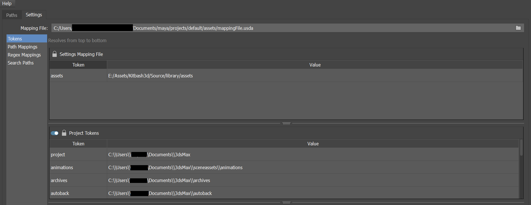

Tokens: The Tokens view displays all available tokens grouped by named group, showing their Key and Value pairs. The paths displayed in the Settings Mapping File section are locked and read-only because they are set by the Mapping File.
The Project Tokens are a special context data group automatically added by 3ds Max. The group can be enabled or disabled to let the USD Asset Resolver use the directories defined in 3ds Max’s project window as search tokens. When enabled, your current 3ds Max project folders automatically become tokenized search locations. Project tokens can be enabled or disabled using the Project Tokens toggle.

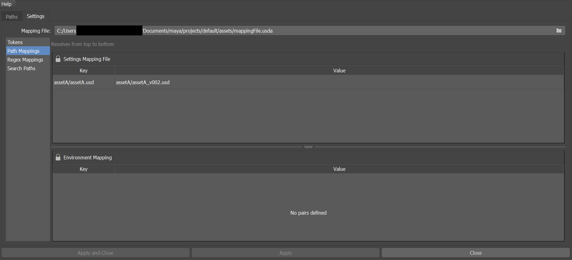

Path Mappings: Path Mappings are organized by named group priority (strongest to weakest). Each path mapping shows its Key and Value pair in a columnar layout and are read-only since they are read from the Mapping File. They provide visibility into which path substitutions are active during USD asset resolution, helping diagnose unexpected path behavior when working with references, payloads, and sublayers.

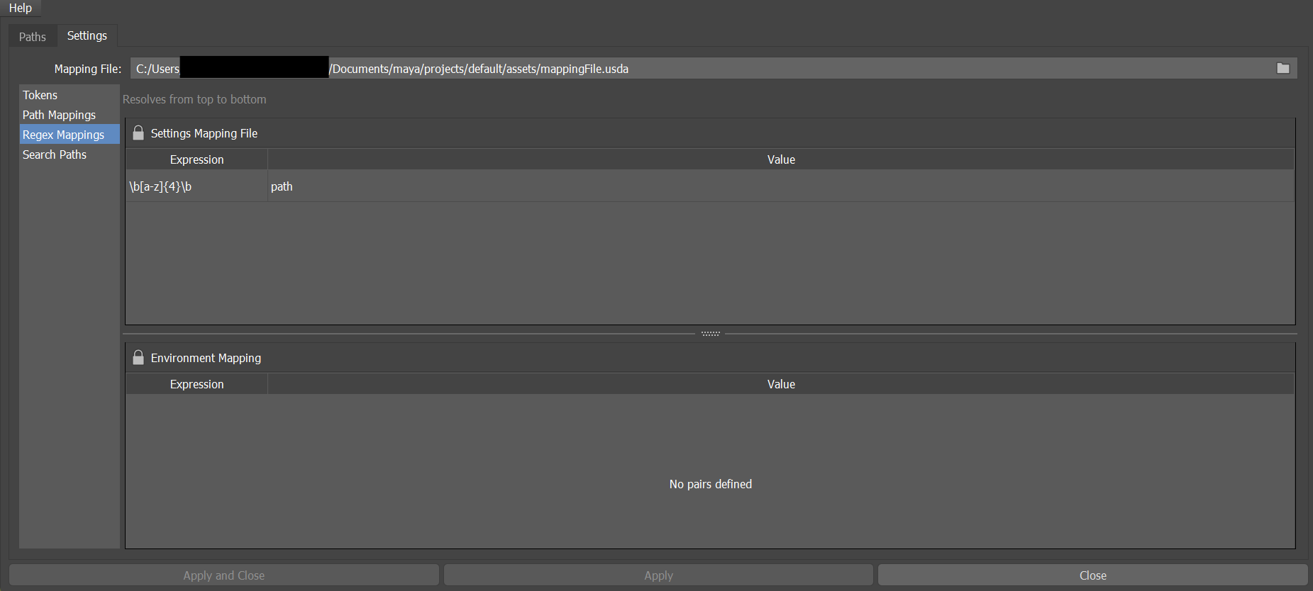

Regex Mappings: Similar to the Path Mappings, Regex mappings are organized by named group priority (strongest to weakest). Each regex mapping shows its Expression and Value pair in a columnar layout, they are also locked and read-only since they are read from the Mapping File as well. They give visibility into which regex-based path substitutions are active during USD asset resolution.

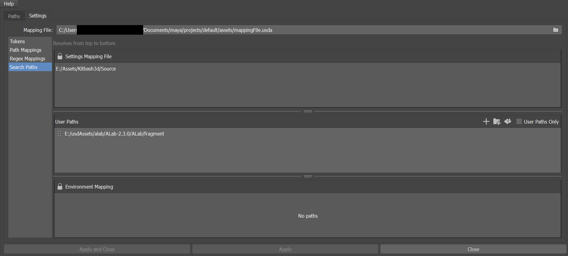

Search Paths: Search paths in the top section Settings Mapping File are read from the loaded Mapping File and are displayed as read-only rows.
Important:
The order of search paths affects performance. Place paths that are used most often at the top of the list for faster resolution. Avoid using broad or root-level paths (for example, C:), as they can significantly slow down searches.
The User Paths section is an editable context data group that lets you set and organize specific search paths. There are several controls:
