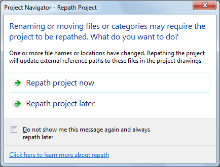

    The Project Navigator - Repath Project dialog box displays.
  3. Specify when you want the repathing to be done:
    If you want to… Then…
    update all project files now click Repath project now.
    update all project files later click Repath project later. If you close the project before repathing, the drawing files remain in a queue for update and will display in the Project Repath Queue dialog box the next time you open it.
