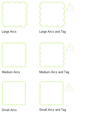

Revision cloud annotations are used for marking up to-be-revised areas in a drawing. Formerly available as content blocks in DesignCenter, these annotations are now available through tools on the tool palettes and in Content Browser.
Revision cloud tools
If a revision cloud has a tag, the tag symbol is a block reference which can be controlled by annotative scaling. The polyline representing the cloud shape does not participate in annotation scaling.
