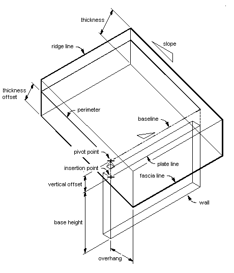

The body of a slab or roof slab is an extrusion perpendicular to the plane of the perimeter and is defined by the following geometry:
Slab/Roof Slab Edges
The following parameters define a slab or roof slab edge:
You apply a fascia and soffit to slab or roof slab edges with styles that define edge conditions
Edge Control
You can customize each slab or roof slab edge individually, applying styles and making other adjustments as required by your design. A slab or roof slab edge style defines the fascia and soffit design from profiles that you create for these components. You can specify whether the style uses a fascia, a soffit, both, or neither. You also specify how the fascia and soffit are positioned relative to the slab or roof slab.

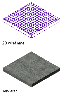

Slab appearance in different views
AutoCAD Architecture 2027 toolset provides predefined materials for common design purposes. These materials contain settings for slabs or roof slabs that you can use as provided or modify for special designs. You can also create materials from scratch. If you create a material to use only for slabs, name it accordingly; for example, Slab—Ceramic Tile or Slab Edge—Concrete. This will help in organizing your material definitions.
