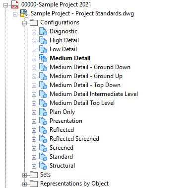

Standard display settings can be accessed, edited, synchronized, copied, and updated in Display Manager.
Standard settings in Display Manager
