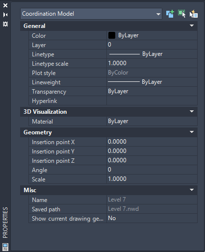

Change the Properties of an Attached Coordination Model
  1. To display the Properties palette, double-click the coordination model or the bounding box around the model.
  2. In the Properties palette, do any of the following:
    • Change the insertion point by entering new X, Y, Z values.
    • Change the rotation by entering a new value.
    • Change the scale by entering a new value.
    • Set Show Current Drawing Geometry to Yes or No.
The coordination model updates in real time as you change settings in the Properties palette.
