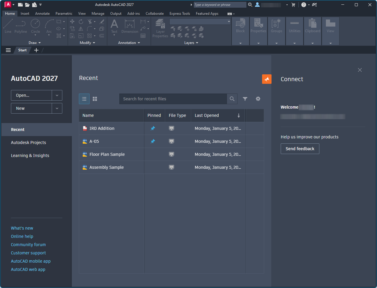

About the Start tab
The Start tab is displayed by default at startup, providing easy access to a variety of initial actions, including access to drawing template files, recently opened drawings and sheet sets, online and learning options, and announcements.
The Start tab contains the following information:
Open
Opens a previously saved drawing file.
Open drop-down
The Open drop-down contains the following:
  • Open files - Opens a previously saved drawing file.
  • Open a sheet set - Opens a previously saved sheet set.
  • Explore sample drawings - Access the installed sample files.
New
Creates a new drawing from the default drawing template file.
You specify the default drawing template file from the Options dialog box, Files tab and expand Template Settings > Default Template File Name for QNEW.
New drop-down
The New drop-down contains the following:
Templates
  • Recent templates - View the most recently used templates.
  • Browse templates - Lists all the available drawing template files.
  • Get more templates online - Download additional drawing template files when available.
Sheet Sets
  • Create sheet set - The Create Sheet Set wizard is displayed.
Recent
View the most recently used documents and their activities with the Activity Insights palette. You can keep a document listed by pinning it. A pinned document is displayed at the top of the list until you unpin it. You can choose between the display options for image and text or text only. For more information see To Work With the Recent Documents List in the Start tab.
Autodesk Projects
Autodesk Projects provides a way to open & save files to your connected drives and the related hubs, shared projects, and respective folders and files. You will need to have Desktop Connector installed to access the projects in Forma Data Management. For more information see Install Desktop Connector.
Desktop Connector
Desktop Connector is a desktop service that integrates an Autodesk data management source (or data source) with your desktop folder and file structure for easy file management.
The files in the data source are replicated in a connected drive. You can manage files in the data source through the connected drive, just as you would any other folder on your machine. Changes made in the connected drive are automatically uploaded to the data source.
Learning
Learning provides access to learning resources such as videos, tips and other relevant online content or services if available.
Note: If no internet connection is available, Learning is not displayed.
My Insights
My Insights is information that's shown to you based on your usage of AutoCAD. The content is designed to be informative and actionable.
Insights can also be emailed to you or viewed under Reporting Insights in your Autodesk Account. An email is sent out about once a month and only when we have new insights to share.
Learn more about My Insights.
Note: My Insights are not available in AutoCAD LT.
Links to other online resources
These links provide easy access to important online resources.
Announcements
Displays announcements for product updates, surveys, and more.
Connect
Sign in to your Autodesk account to access online services.
Send Feedback: Opens the online form where you can provide feedback and suggestions for improvements.
