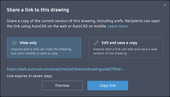

Share a link to a copy of the current drawing to view or edit in AutoCAD on the web (web.autocad.com) or AutoCAD on mobile. The drawing copy includes all external references and images.
Find
For drawing files saved in Forma Data Management
Select Can edit to share a link that allows recipients to make changes to the actual drawing file. Project members who receive the link and have editing permissions in Forma Data Management can modify the drawing. Or select View only to share a link to the drawing that can't be modified or saved.
For drawing files that aren't saved in Forma Data Management
Select Edit and save a copy to share version of the file that can be modified and saved as a copy. Or select View only to share a link to the drawing that can't be modified or saved. Anyone with the link can access the drawing in the a web browser or in the mobile app. The link expires seven days after it's created.
