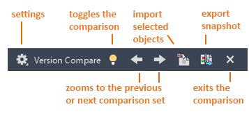

The Version Compare toolbar helps you perform a variety of functions:

  1. Click Settings on the Version Compare toolbar.
  2. In the Settings panel, click the controls that you want to change.

  • To toggle the visibility of the revision clouds, click the light bulb icon.

Click the On or Off button to hide the comparison results temporarily as you work in the current drawing.
Navigate Between Change Sets
Click the right and left arrows to zoom into the next or previous change set.

  1. Click Import Objects to import selected objects from the compared drawing into the current drawing.
  2. Select the objects in the comparison drawing that you want to copy into the current drawing and press Enter. Only those objects that are not in the current drawing can be imported.
The objects you selected from the comparison drawing are copied into to your current drawing and no longer differ between the drawings.

  1. Click Export Snapshot to combine the two comparison drawings into a new snapshot drawing file for further review.
  2. In the Export a Comparison Snapshot dialog box, click Continue.
  3. Save the drawing file. By default, the file name is Compare_Drawing 1 vs Drawing 2.dwg .
This operation creates a new drawing file displaying the differences between the two files.

Click Exit Compare to end the comparison and close the Version Compare toolbar.
