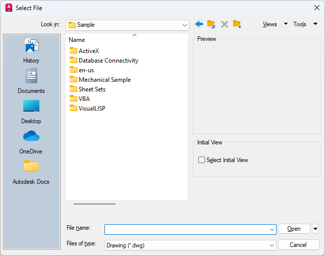

Standard File Selection Dialog Boxes
Several commands display standard file selection dialog boxes, in which you can navigate through local and network drives and through FTP sites and Web folders to select files. While each dialog box may vary slightly, following is a list of the possible options.

The following options are displayed.
Places List
Provides quick access to predefined locations, including those from cloud storage providers. Reorder the icons in the Places list by dragging them to a new position. To add a new shortcut to Places, drag a folder onto the Places list. Right-click a folder that you want to remove and click Remove from the menu.
Changes to Places affect all standard file selection dialog boxes.

Look In/Save In
Displays the current folder or drive. Click the arrow to view the hierarchy of the folder path and to navigate up the path tree or to other drives, network connections, FTP locations, or web folders (either Web Folders or My Network Places, depending on the version of your operating system). You can create web folders in File Explorer. Consult your system administrator or Windows Help for more information about web folders. To control whether the last used paths in each particular standard file selection dialog box are stored across sessions, use the REMEMBERFOLDERS system variable.

Views
Controls the appearance of the Files list or Folders list and, for a Files list, specifies whether to show a preview image when a file is selected.

Files List
Displays the files and folders in the current path and of the selected file type. Use the Views menu in the dialog box to switch between List view and Details view.

File Name
Displays the name of the file you select in the Files list. If you select multiple files, File Name displays each selected file within quotation marks. You must use quotation marks when entering multiple file names. You can use wild-card characters to filter files displayed in the Files list. For information on wild-card searches, see Wild-Card Characters Reference.
Files of Type
When you are saving files, Files of Type specifies the format in which the file is saved.
