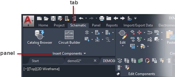

The tutorial uses a naming convention when referring to ribbon commands. For example, in the selection path Schematic tabInsert Components panelCircuit Builder, Schematic is the name of the tab, Insert Components is the name of the panel on the tab, and Circuit Builder is the name of the command.
